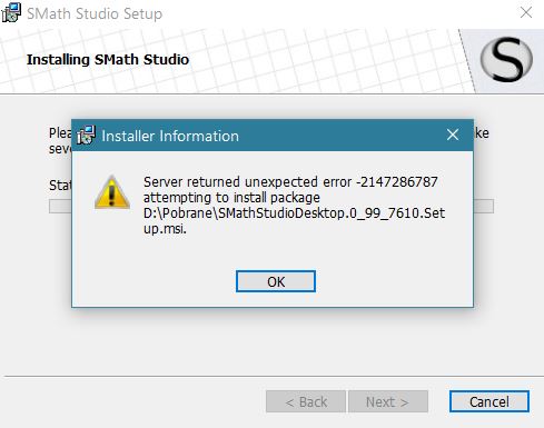

#7 Опубликовано: 01.03.2021 12:17:23
montee248
montee248
Hi everyone
I'm struggling with installation, unfortunately there is some error that I can't solve. I checked .NET Framework, try to reboot but it appears everytime. I'm working on Win 10 x64 ver. 1809
Is there somebody who might have an idea how to resolve it?
Older versions of SMath also struggles with the same problem ;/
Thanks for help
