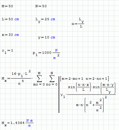

Sure. Just take odd numbers.

Thanks for the help. Not sure why I got so hung up on this. Seems relatively easy now...
