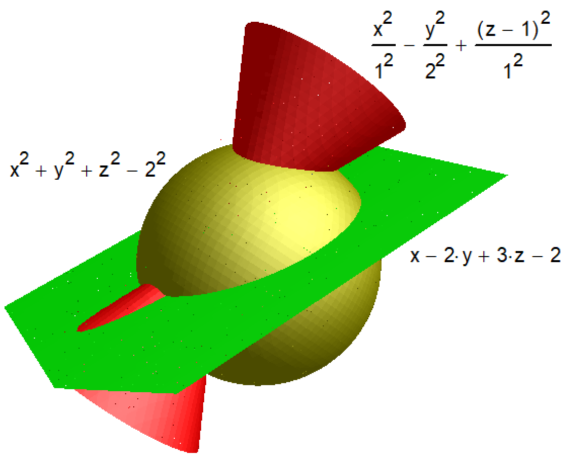

Findroot() or roots() could solve three unknown systems.
About plotting, I simply wrote equations according to solving of z.
3Dplot_OchkovVF.sm (4,51 КиБ) скачан 1554 раз(а).

Is there a way to use CreateMesh() for single line xyz equations?
x^2+y^2+z^2-2^2 creates a sphere in 3dplot, a finer mesh can look better.
But I don't know how to convert an equation to CreateMesh().
I am asking if it is doable of course, if they are two different thing it is ok.
A simple, short but inclusive tutorial would be beneficial.
WroteIs there a way to use CreateMesh() for single line xyz equations?

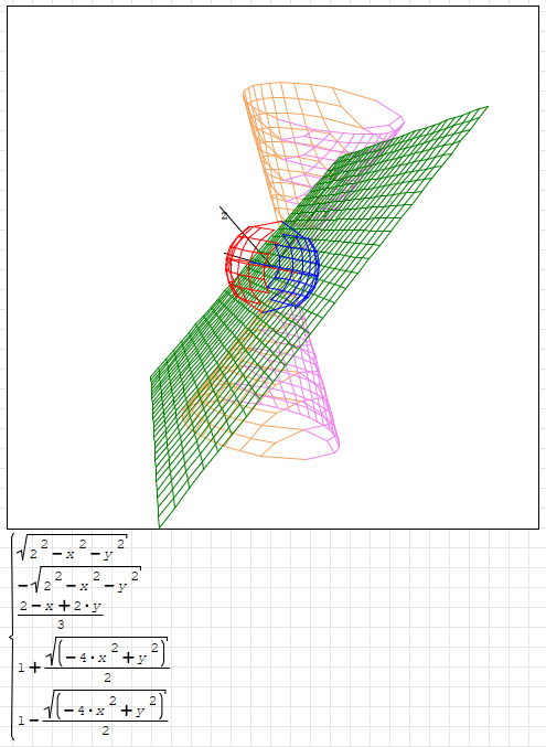

Like in the attached? (Though I confess it was a "suck it and see" approach as I don't fully understand the 3D graphing!)
TriangleSpherePlaneCreateMesh.sm (6,92 КиБ) скачан 1625 раз(а).
WroteLike in the attached?
Not really, my question is different.
You can make any object with CreateMesh().
You can make sphere, plane, cone, cube, etc with mesh.
I ask for a method converting a xyz function to CreateMesh() matrix.
If there is any of course.

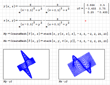

Hi Overlord. If you can isolate some of the x, y or z variables, you can use this. If not, Viacheslav develops a 3D implicit plot codes for mathcad, you can see that somewhere in the mathcad forum.
create_mesh_xy.sm (8,42 КиБ) скачан 1606 раз(а).

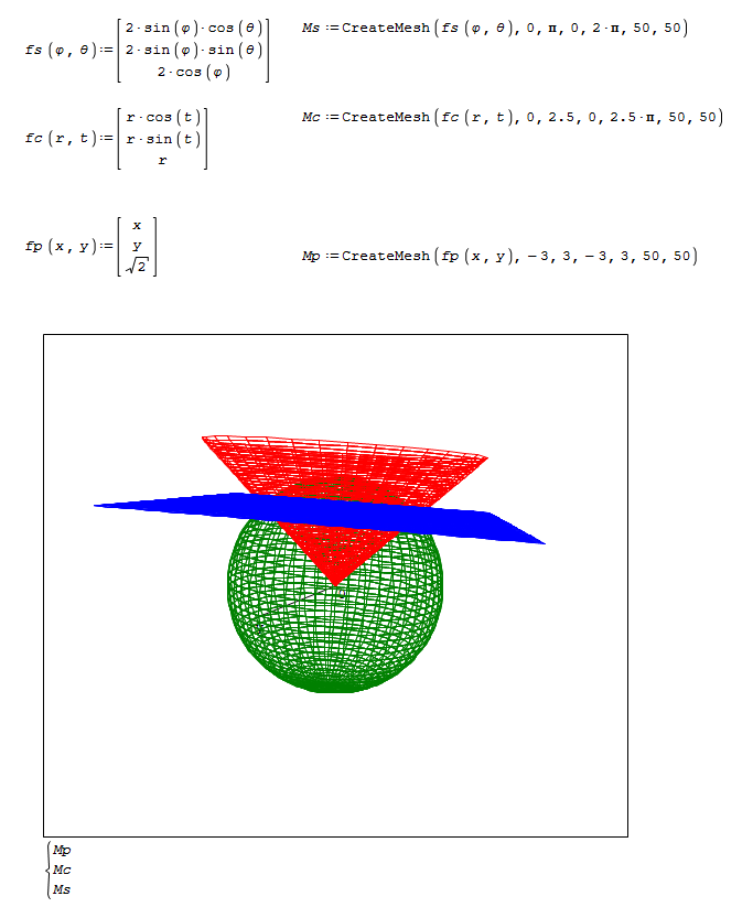

Вячеслав Мезенцев 29.02.2024 16:48:00
WroteIf not, Viacheslav develops a 3D implicit plot codes for mathcad, you can see that somewhere in the mathcad forum.
The dots on the graphs above are a sign of my code being used.
WroteI ask for a method converting a xyz function to CreateMesh() matrix.
This is only possible for simple cases if the function is easily parameterizable.
