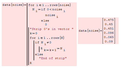

Pretty simple to zap negative values:
1. transform negatives to '0'
2. strip vector from '0'
No need using Smath Viewer.
Cheers ... Jean.
Random [rnd(n)] Filter.sm (10 КиБ) скачан 142 раз(а).
Composite clean negatives.
Thanks Jean, but it's not the case.
I have an long application developed in Smath Studio using Smath Viewer, and some of my algorithms need's a positive input for bending moment's. For now showing a warning message, and using an absolute value work, it's not the more elegant solution, but work.
