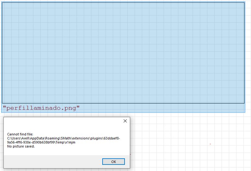

Hello guys,
I don't know what's going on, but my ImageRegion doesn't work. A blank image remains and when saved the following message appears:
#2 Опубликовано: 10.04.2021 05:08:28
2 328 сообщений из 4 021 понравились пользователям.
Группа: Super Administrator
This is because of correction related to special characters made in MathRegion in the last beta of SMath Studio.
It seems we need to update many plug-ins now.
Everywhere where text from Math Region is taken we need to use TermsConverter.DecodeText(text) first.
I've investigated it a bit and see that this error was always there but it was not so often visible because less chars was encoded earlier.
#3 Опубликовано: 10.04.2021 07:57:18
ImageRegion fixed now. Please update it using Extensions Manager.
#4 Опубликовано: 10.04.2021 08:07:47
LeandroMartins
LeandroMartins
1 сообщений из 9 понравились пользователям.
Thank you so much Andrey! It´s works now

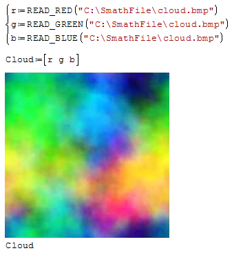

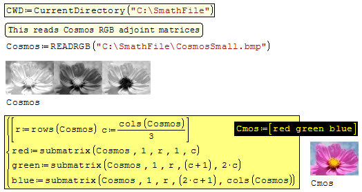

I don't know what's going on, but my Image Region doesn't work.
You can try earlier SS 6179 simpler way
i.e: assign the image as a plotable image argument.
#6 Опубликовано: 10.04.2021 10:11:12
CWD is not needed ...
