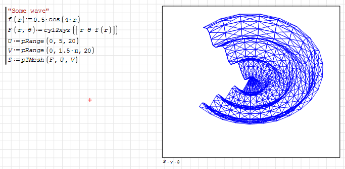

Hi. There are several variants for the triangular meshs. This is one.
pTriMesh.pdf (459,2 КиБ) скачан 788 раз(а).
pTriMesh.sm (29,35 КиБ) скачан 1403 раз(а).

Hi. Here are some notes about how the mesh is constructed. To include the missing vertices, they would have to be inserted at least twice, when drawing the diagonals. It could be done by constructing the mesh as it is, and instead of drawing the entire diagonal, to the center of the squares, but it could be a slow procedure. For another example, please see https://en.smath.com/forum/yaf_postsm74527_Offset-surface-creation.aspx#post74527
pTriMesh work.sm (28,8 КиБ) скачан 1354 раз(а).

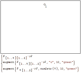

This other have the intesections as part of the mesh.
pTriMesh_v2.sm (48,39 КиБ) скачан 1392 раз(а).

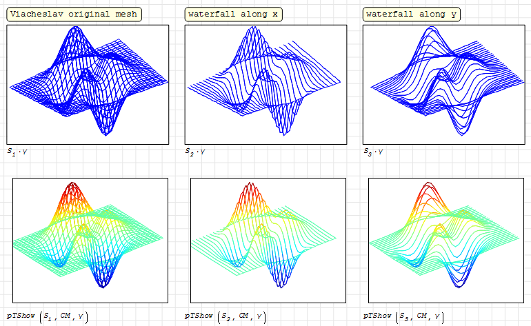

Hi. More general mesh utility, with a variable patern. Also, waterfall plots (matlab page here).
pWMesh.sm (193,8 КиБ) скачан 1389 раз(а).
pWMesh.pdf (3,2 МиБ) скачан 846 раз(а).
