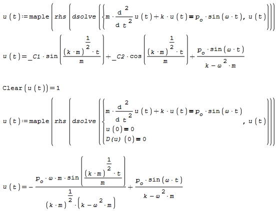

How to get symbolic results from ODE?
#2 Опубликовано: 30.06.2024 21:32:27
1 545 сообщений из 1 861 понравились пользователям.
Symbolic results from ODE.sm (9,74 КиБ) скачан 1291 раз(а).

Thank you. How do you input ",u(t)" in the brace?
I think so
dsolve( , u(t))

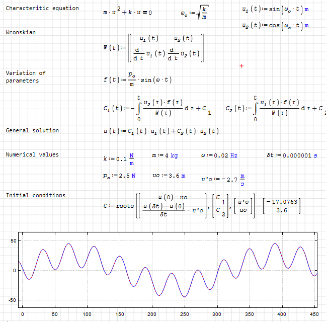

Plugin less solution, with units, using the Wronskian and the variation of parameters method.
Symbolic results from ODE.sm (23,52 КиБ) скачан 1246 раз(а).
