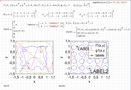

With the latest SS 0.99.7921.69, the XYPlot fonts appear enlarged compared to previous versions.
No problems with ZedGraph.

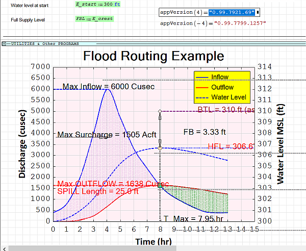

Another example where XYPlot fonts enlarged.

It looks like it has something to do with the monitor's high resolution. There is no such effect on my current monitor. If this is the case, then I can't make the fix now. I need access to a higher resolution monitor for testing.
