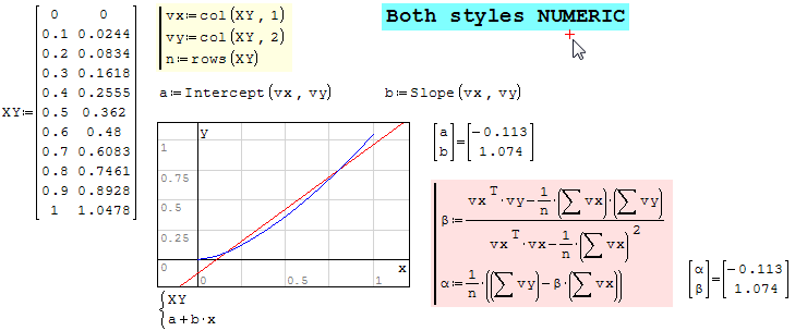

Can't explain to myself double/triple nesting [6179 Win 7].

Thanks Davide ... works fine Numeric !

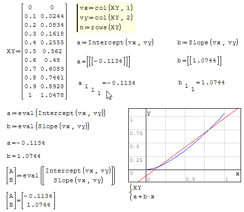

Carlos, try this one [done Smath 6179]
Maths SlopeIntercept.sm (9,07 КиБ) скачан 1259 раз(а).

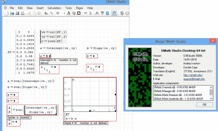

Thanks Jean, but I get the same error.
Is your Smath studio 32-bit?
My Smath Studio 64-bit, does not recognize the
functions of Interception and slope.
WroteMy Smath Studio 64-bit, does not recognize the

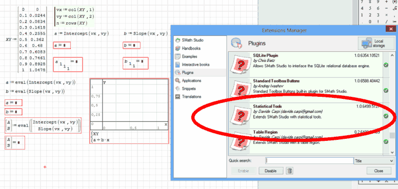

WroteThe Functions are in Statistical Tools Plugin.
Carlos, do you have statistical tools plug-in installed and enabled?
I see, trying to figure out what's happening here
