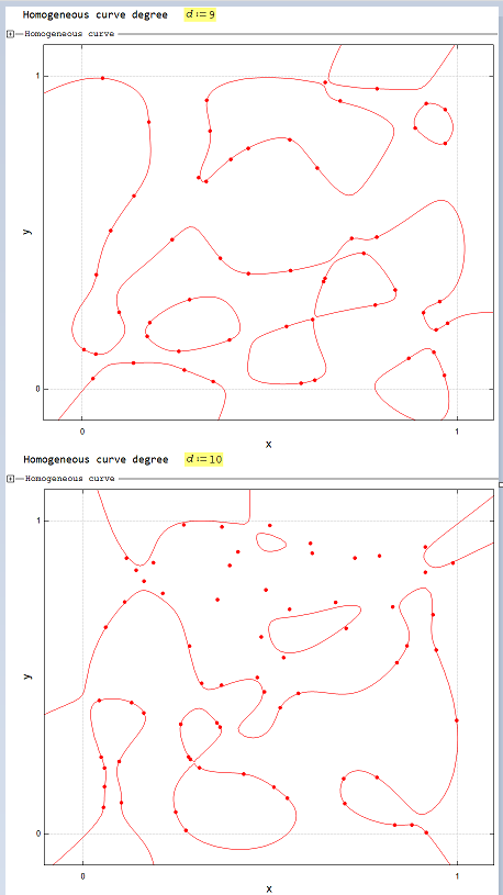

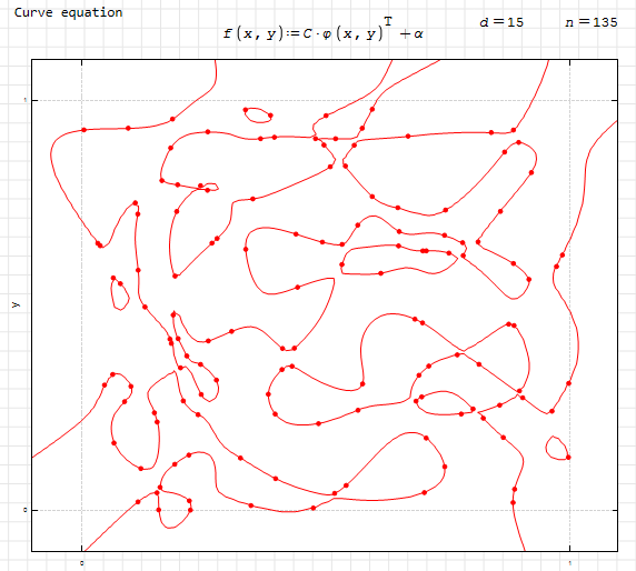

#3 Опубликовано: 31.10.2023 09:58:55
General case.
Homogeneous Curve.sm (27,07 КиБ) скачан 1366 раз(а).

#8 Опубликовано: 01.11.2023 02:16:45
... Yes, Vladimir is a very famous name - Vladimir Lenin, Volodymyr Zelensky, Vladimir Putin...
But fortunately I am Valery ;-)
Please, excuse me. I generally remember faces a little better, but I'm a disaster with names.
By the way, if you do not have enough knowledge, skills, or simply time to solve a problem, then you can “post” it on the forum and wait for a solution. Here is an example of such work https://en.smath.com/forum/yaf_postsm82878_Cubic-lines.aspx
In maintenance we say: the important thing is not to know how to repair something, but to have the phone number of someone who knows.
See please
https://oeis.org/search?q=2%2C+5%2C+9%2C+14%2C+20%2C+27%2C+35%2C+44%2C+54%2C+65%2C+77%2C+90%2C+104&language=russian&go=%D0%9F%D0%BE%D0%B8%D1%81%D0%BA
Yes, that's the sequence. It is the number of coefficients that have a homogenous bilinear form in two variables. And is the number of rows in the matrix 'v' in the file.
Limit at n=10
I put the comments backwards. For big n, disable the SMath matrix inverse method and use dn_LinAlgSolve.
Homogeneous Curve.sm (31,07 КиБ) скачан 1291 раз(а).

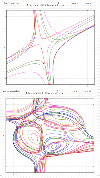

#9 Опубликовано: 01.11.2023 02:54:32
I suppose it can be easily generalized to three dimensions, except for the part of graphing the surface, since there we would not have the usefulness of XYPlot to graph implicit functions.
With n level curves, one passes through each X,Y pair at level Z. For d=1, we have a plane, d=2 a quadric, etc.
Homogeneous Surface.sm (33,63 КиБ) скачан 1366 раз(а).
