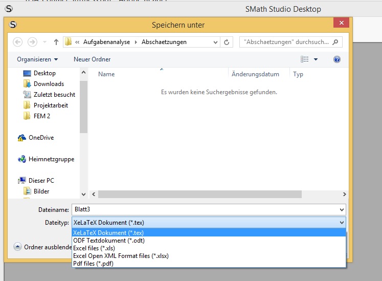

One of my student experience a strange problem under win 8.1: the sm association to smath is lost and smath does not know sm files any more in the open and save dialogs. It just knows the formats from external plugins, see screenshot. This behaviour has developed spontaneously without any apparent reason.
SMath Studio: SMath Studio Desktop 0.97.5346.24640, portable, x86
OS: Microsoft Windows NT 6.2.9200.0 (Microsoft Windows 8.1, x64)
Screen: 1366x768 px, 96x96 dpi
Localization: separator=; decimal symbol=; system decimal symbol=; language=GER
Frameworks: CLR 2.0.50727.8009
installed versions:
v2.0.50727 2.0.50727.4927 SP2
v3.0 3.0.30729.4926 SP2
v3.5 3.5.30729.4926 SP1
v4
Client 4.5.51641
Full 4.5.51641
v4.0
Client 4.0.0.0
