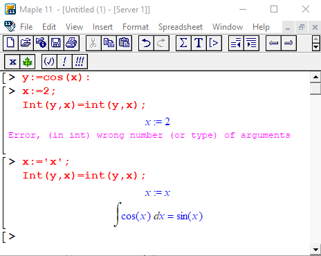

Hi. It isn't in other software, like maple. Usually it must to be an undefined name:
frapuano 23.04.2019 15:20:00
