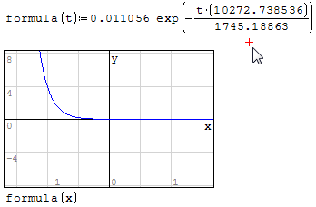

Have you got the same ? easy to sanity check.
