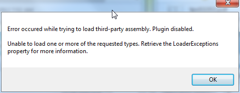

I placed ExcelCollab.dll in C:\Program Files\SMath\SMath Studio\plugins and received the following error:
Error occurred while trying to load third-party assembly. exportcell was not available.
I am using Version 0.95.4594 on Windows 7. Would you assist.

I've recompiled plugin. Please try it.

Thank you for promptly looking into this issue.
The re-compiled file was read into Smath! And I see the commands importCell and exportCell!
I am trying to reproduce the examples in the Collaboration with Excel post but need more time.
