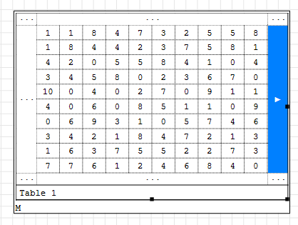

Hi. I guess that the effort less way is putting the matrix into a Table region, and using the 8 three dots that appear at borders and edges for navigating in the matrix.

I like the idea of tables; however, as far as I can tell, it will not do continuous scrolling. Maybe I am missing something.

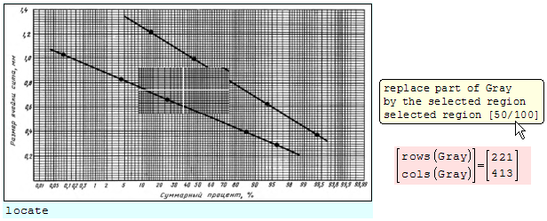

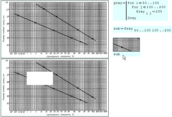

Download this one, confirm you can open.
Simply a bit more descriptive, cross hair helper from Padding the region
Padding is what we use to zoom Fourier a gray or RGB image, up to zoom 2.
For larger zoom, I use IrfanView or WinGrab.
Cheers ... Jean. Take Care.

You are not missing anything.
There is no continuous scroll for table region.
