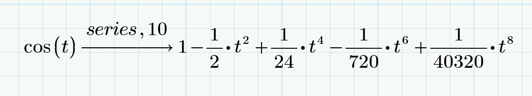

I can do in mathcad Prime
How to do it in SMath Studio?

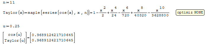

Hi. First, because "Taylor" isn't the maple command, it is "taylor", in lowercase. Second, because maple returns the answer with an "O" notation. You can use convert/polynom to get a result that SMath can handle.
SMath' maple plugin use version 6; here you can find two maple manuals, but for maple 7: https://www.maplesoft.com/documentation_center/history.aspx

Symbolic Convert Parfrac Primary FNCTS.sm (118,96 КиБ) скачан 1310 раз(а).
