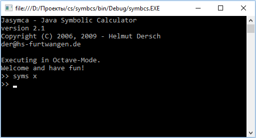

#6 Опубликовано: 05.02.2019 22:18:47
Updated ( github ).
The project can be compiled, but still does not work as expected.

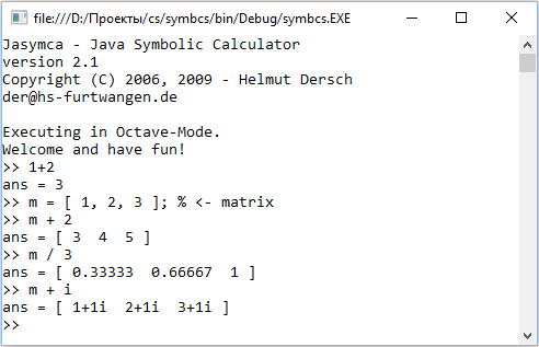

#7 Опубликовано: 08.02.2019 11:14:39
Simple calculations now work.

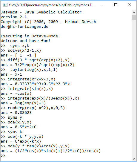

#8 Опубликовано: 08.02.2019 19:05:16
More functions.
