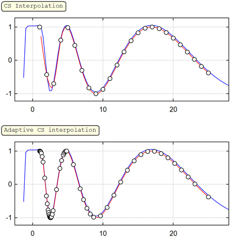

Hi. I have some issues in the attached.
Thanks in advance.

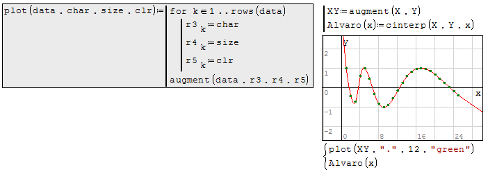

#2 Опубликовано: 28.08.2018 15:12:16
Thanks in advance.
Two red remain ... but here the XY plot.
Cheers, Jean

Hi Jean. Thanks, but you know me ... I want to use my own function.

Hi Jean. There are not to much shadow in that small code. It's just the implementation of the traditional spline interpolation. In SMath there are not, or I can't found, the function cspline. The interpolation with cinterp in SMath evaluates the vector V each time that you call it, it's always better to have V=cspline(X,Y) and then call interp(V,X,Y,x). Finally, I want to implement an adaptive step size for the intervals in X. But first I see very convenient to have vectorization and plotting issues solved.

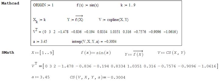

CS only do what mathcad's cspline do:

CS only does what Mathcad's cspline does:

CSplines with adaptive steps. Same issues, but now can use zero with units, at least in the adaptive case.
adapt cspline test.sm (83,25 КиБ) скачан 1074 раз(а).
