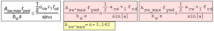

WroteAsw,max â Asw_max
... just a bit pest in numerator vs apostrophe.
No recollection of such a demand in 15 years Mathcad.
No recollection Mathcad special characters can do.
ISO-5167 [Orifice Plate] is lot more maths,
but lot closer to executable maths, almost 1/1.
