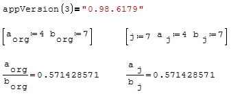

If I enter following operation:
a.org := 4
b.org := 7
r := b.org/a.org =
After entering "=" Smath hangs up.
"org" is a subscript.
I deinstalled Build 7089 and installed Build 7030. The bug disappeared.
