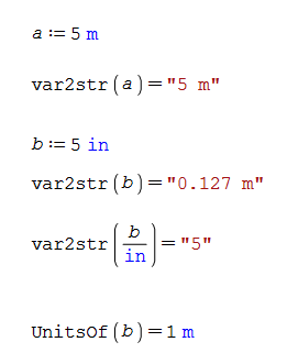

This is probably not possible given what I have already read on other related posts, but I just want to see if anyone has any ideas.
When we define a variable, we have the choice to change the unit we display with that defined variable. We usually need to do this if the desired unit is something different than what is the default unit.
We can use var2str(1) to convert that value and unit to a string, so long as the unit is the default, the string will match the original input.
If the unit is not a default unit, then the string will show whatever value was originally defined, converted into the default unit.
The only thing that seems possible at this time is t manually cancel out the units before converting to a string in order to keep the original value, but the unit text is now lost.
other functions like UnitsOf(1) also only display the default unit.

Is there a way to convert the defined variable into a string while keeping the original unit shown?

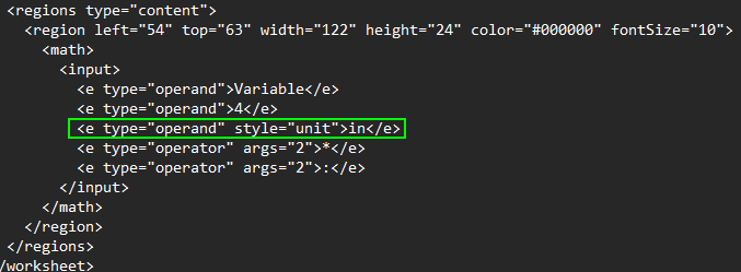

To add to this, if we define a variable, along with a unit (not a default unit).
Then we open the .sm file in note pad and look at code, we see that the "unit" operant of "in" is defined.
So why can't we get that bit of information for use in other operations?

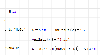

... Is there a way to convert the defined variable into a string while keeping the original unit shown?
Hi. Artificial, but it's a way. A Hold() function obviously is better:

Hi Alvaro,
Thanks for this initial try.
I would like to avoid using the mathcad plugin. Not a huge fan of how the variable is defined, and in the end, if this is the only way, maybe just mathcad is a better solution...
Realistically, this probably requires an additional special function, that allows you to recall the "displayed" units.
As I have shown, code contains the display units as an operant, so this should be able to be recalled in some way.
I know a lot of people would just want to see a way of showing the initial substitution, but this request has been put forth for over a decade now with no result, so it must be hard, or the dev team is not financially motivated for this.
Personally, I think that this type of feature would really make Smath a better engineering calculation tool.
So, if this can't be done, then at least this simple request to recall the displayed unit can be done, and then with what you have already done, we can make a function that does this substitution for us.
