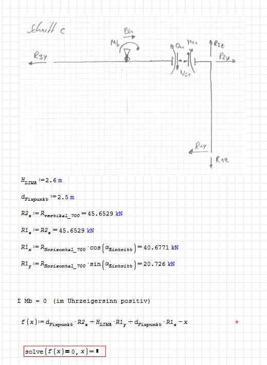

WroteI can't find the error. I want to solve a simple linear equation for a static problem. But with the solve() function I can't enter units.
Generally, solve blocs aren't units compatible.

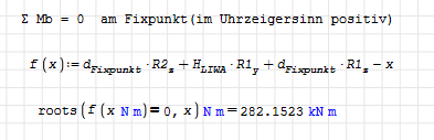

There is no "solve block" there. For the real ones there is a plugin. In any case, there is a function to find roots, which is compatible with the use of units, you just have to know how to use it and in what cases. For this function, the roots function seems more suitable instead of solve. Try with this, for example

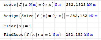

In your initial post, just replace solve() by Solve(). This requires the Maxima Plugin being installed.
It is a symbolic solver, which has generic unit handling, i.e. the unit of the result is determined by the solver.
An alternative is the FindRoot function, where you have to provide an initial guess (starting point for the numeric solver) and the result is automatically assigned to the variable.
The maxima solver returns an equation variable=solution, which can be converted into an assignment by the Assign() function. More details to be found in the handbook (Google SMath Handbuch).
