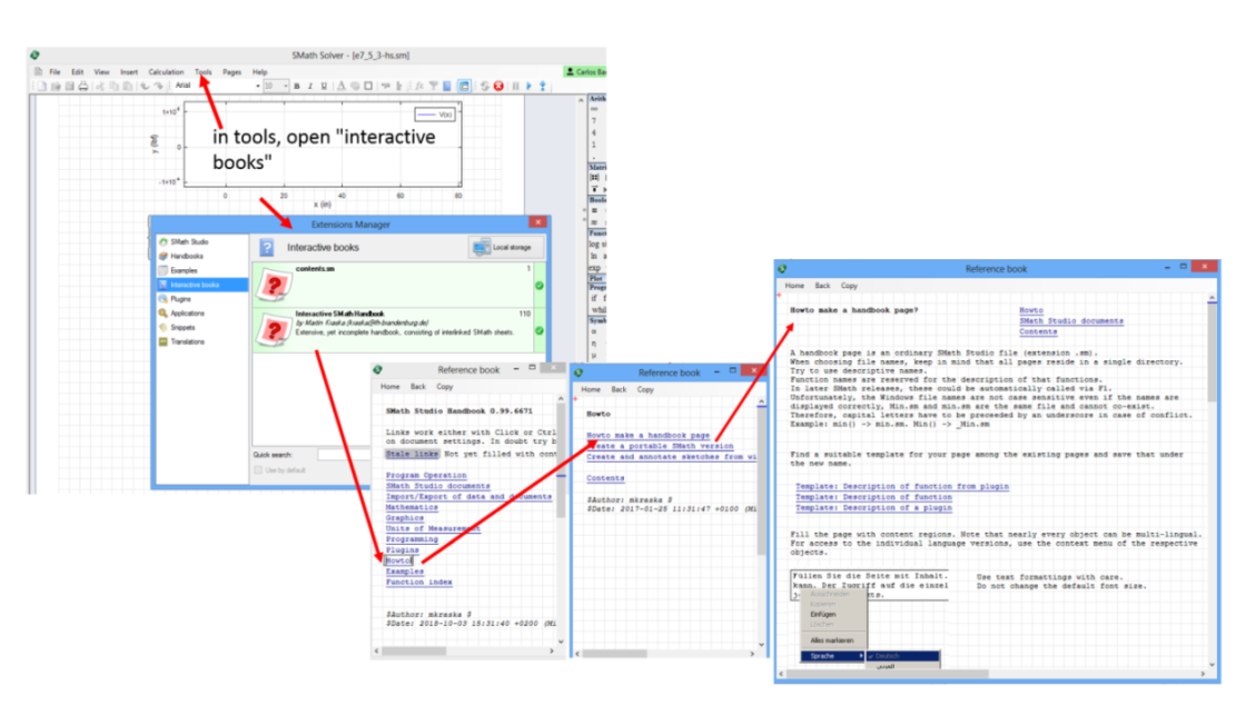

Hello
I think the interactive book query can help you

The links in your book don't work for me. It seems that batch production of links using the toolbox from the text region utilities plugin don't produce valid links any more.
So you might have to edit the xml file as I had to when I started to create the interactive handbook.
