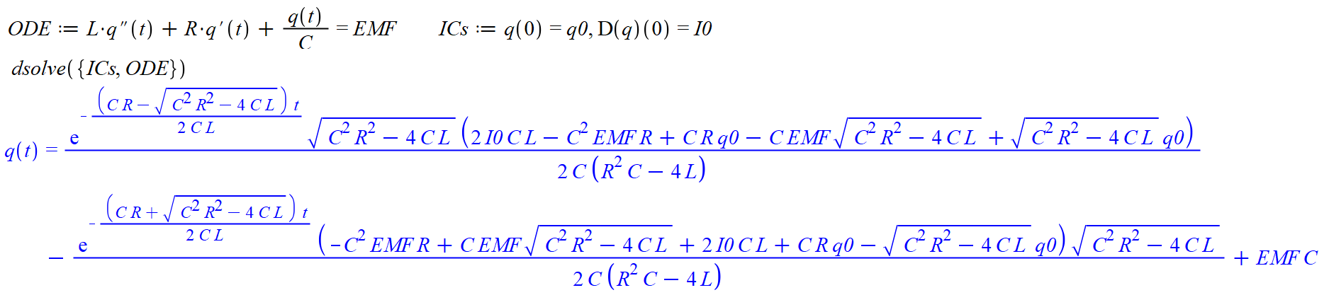

Help, for God's sake!
All students are on vacation, but I urgently need to convert the formula from Maple to Smath.

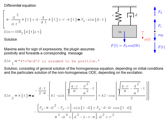

This is how I'd handle it with the Maxima plugin. In the first case with ODE.2(), Solve() can be applied to use the initial conditions to determine the constants of integration k1 and k2. In the second case with desolve() the initial conditions are specified beforehand with atvalue(). You get the symbolic solution if you disable the value assignments to the system constants.
2024-02-05 10_32_19-SMath with Maxima Inforino 2024 - PDF-XChange Editor.png

#3 Опубликовано: 06.02.2024 14:39:39
Click to enlarge
#4 Опубликовано: 06.02.2024 15:04:46
Valery Ochkov
Valery Ochkov
Click to enlarge
Attach please the sm-file!
