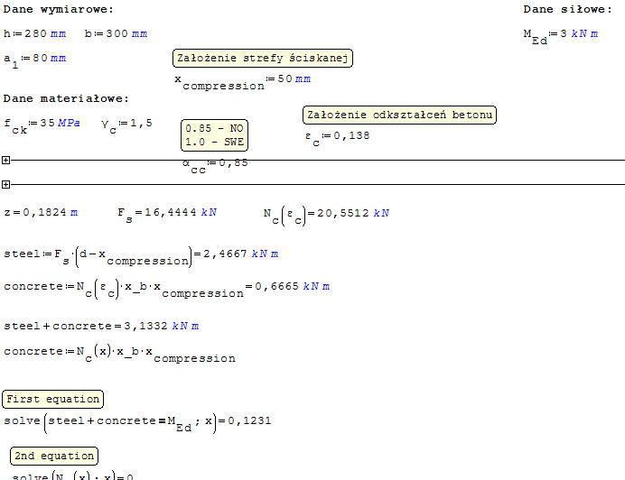

I have an equation, which depends on two other function, which depends on one variable. How can I solve it?
Look at the attached file. smath forum.sm (96,54 КиБ) скачан 1284 раз(а).
In general, I have set of two equations:
Fs=Nc(x)
and Fs*(d-x_compression)+Nc(x)*x_b*x_compression=M_Ed
Now, I implemented all funcitons as function of x (x stays for Ec - strain in concrete), but I can easily manipulate compression zone (x_compression) if necessary, as it is also not given as "constant".
At the beginning I define dimensions (b,h,a1) and material (fck, gamma_c, alfa_cc). I also assume compression zone and strain in concrete and I have bending moment M_Ed. Rest (and also x_compression and E_c) are editable/may change and depend on each other.
Could you please tell me what's the easiest way to solve those two equations?
Unfortunatelly, when I am trying to solve(Nc(x)=Fs,x)=0, SMath respond is that x has not been defined.
Any ideas?
BR.
Fs=Nc(x)
Any ideas?
BR.

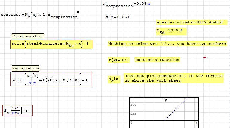

Jean,
thanks for your effort.
You have written:
"nothing to solve as you have two numbers" - not exactly, once you will look into the sum of steel and concrete you may see there Nc(Ec) - Ec is variable.
"f(x) must be a function" - isn't f(x)=123 a function? Still, I don't have any results. I would like to know at what argument Nc(x) is equal to Fs (Nc(x)=16.37, as then I may estimate strains in concrete. I don't know maybe you see a result? I have attached photo.

WroteCould you take one more look at it?
Yes, and the answer is that there is no automatic solution.
Why ? Because the base "concrete(x)" is not a function,
only a discontinuous function, incompatible to the solver(s).
Done manually at the end of the work sheet.
Maybe "Dichotomy" is suitable ?
smath forum.sm (112,07 КиБ) скачан 1311 раз(а).
... "Dichotomy" solves nicely !
Solves for 'x' in "concrete(x)" for any value(s) in MEd(x)
Is it done as expected ? Your stuff is not my cup of tea !
smath forum.sm (116,76 КиБ) скачан 1346 раз(а).
