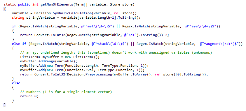

You can try to use/enhance the IsScalar() and IsMatrix() functions of varManager snippet (updated to fix an issue in IsArray(#)).
EDIT: If you are writing a plugin you can use something like the getNumOfElements function in StatisticalTools or NonlinearSolvers plugins

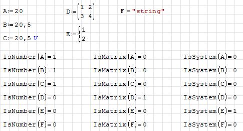

I started a new PlugIn Project called FunctionBox for SMath.
To bring it to life, I added the three requested functions
- IsMatrix
- IsSystem
- IsNumber
I did a lot of SMath plugin programming in the past and will contribute to the SMath project by providing some helpful plugins.
In the near future I will create a Wiki page for the FunctionBox where I describe the already available functions.
Also a post in this forum related to the plugin would be good to discuss new features.
So, find attached the FunctionBox.dll plugin and feel free to test it and provide feedback.
Have fun,
Infinity

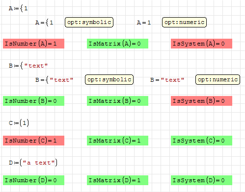

Hi Infinity
I'm very glad that you came back with a new plugin
Just as a feedback the IsNumber fails evaluating infinity and imaginary unit and there are some issues with single elements arrays/systems
