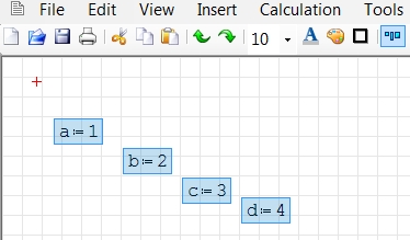

Edit:
Never thought of this way showed in the image to write expressions from left to right.
For every new expression press enter followed by as many spaces as needed to be misaligned vertically and then arrange all blocks with the align horizontally tool.
