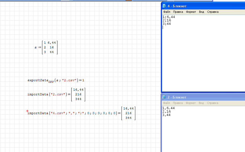

#13 Опубликовано: 20.11.2019 09:44:00
veb
veb
1 сообщений из 38 понравились пользователям.
Hello
Help with Importdate (9)
I want to upload a matrix for the graph in smath. I use the format tsv. I use ";" as a separator. Decimal symbol ",".
What am I doing wrong with import date (9)?
Why I export a matrix with two columns
And I import with one column?
What is the best way to use to import data?

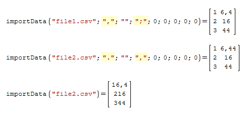

#14 Опубликовано: 20.11.2019 13:07:53
for numerical import, the 2nd and 4th arguments are those you have to set.
importData is a general purpose import function, hence can import even SMath studio data; 2nd and 3rd are decimal symbol and arguments separator "of single entries" (like in SMath Studio settings), 4th argument is the column separator of CSV data.
