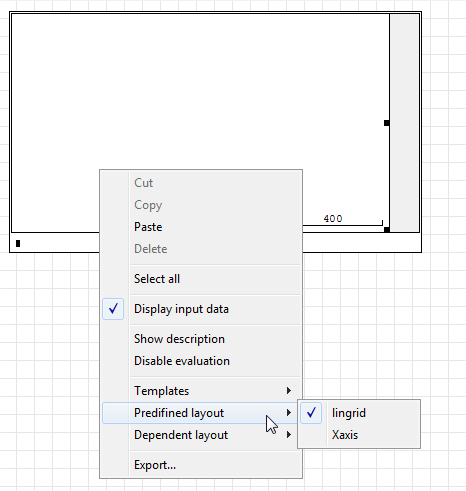

Looking in the SVN repository, I've seen an interesting unrelased/undocumented/(unfinished?) plugin made by Andrey: ConstructorRegion. This plugin create an object to work whit dxf files (see the screenshot).
Although I have not yet entirely understand how it works (both the code and the front-end object) I was literally kidnapped by the potential of this plugin; I think that starting from this plugin a good programmer could create a parallel graphics plugin that implements the missing features of current 2D graphs (I think about the decimal and logarithmic grids, plot limits, histograms, pie charts and others...).
No one feels to try?
best regards,
w3b5urf3r

whats the potential for this plugin to create files for autocad? It'd be nice to be able to export the drawings from smath into files that autocad can read.
