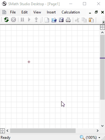

Implementation is in progress, but here is what we have for now:
I believe it will make worksheets debugging much easier!

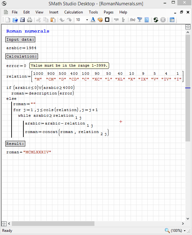

Latest SMath Studio beta released: http://en.smath.info/forum/yaf_postst7659_SMath-Studio-0-98-5997--02-June-2016.aspx
One can play with debugging functionality there.
Please note:
  • Buttons in main toolbar are rearranged;
  • Super handy Pause button implemented - you can found a place where calculation in progress right now in one click! Previously it was absolutely impossible for large worksheets;
  • Watch panel displays changed values in red - it makes much easier to understand what was changed since last step;
  • Breakpoints can be set/removed before calculation started and also when calculation is already in progress;
  • Vertical scrollbar improved to show locations of the regions with breakpoints.
I will slightly improve debugging functionality in future releases and will fix some bugs, but it looks for me very powerful even today!
I also realized, that this feature can also be used in understanding the logic of SMath Studio and in learning to show students ordering of operations in loops and between assignments. One thing I do not understand is why Mathcad do not offers the same possibilities... or at least I did not found anything similar there.
Best regards!
