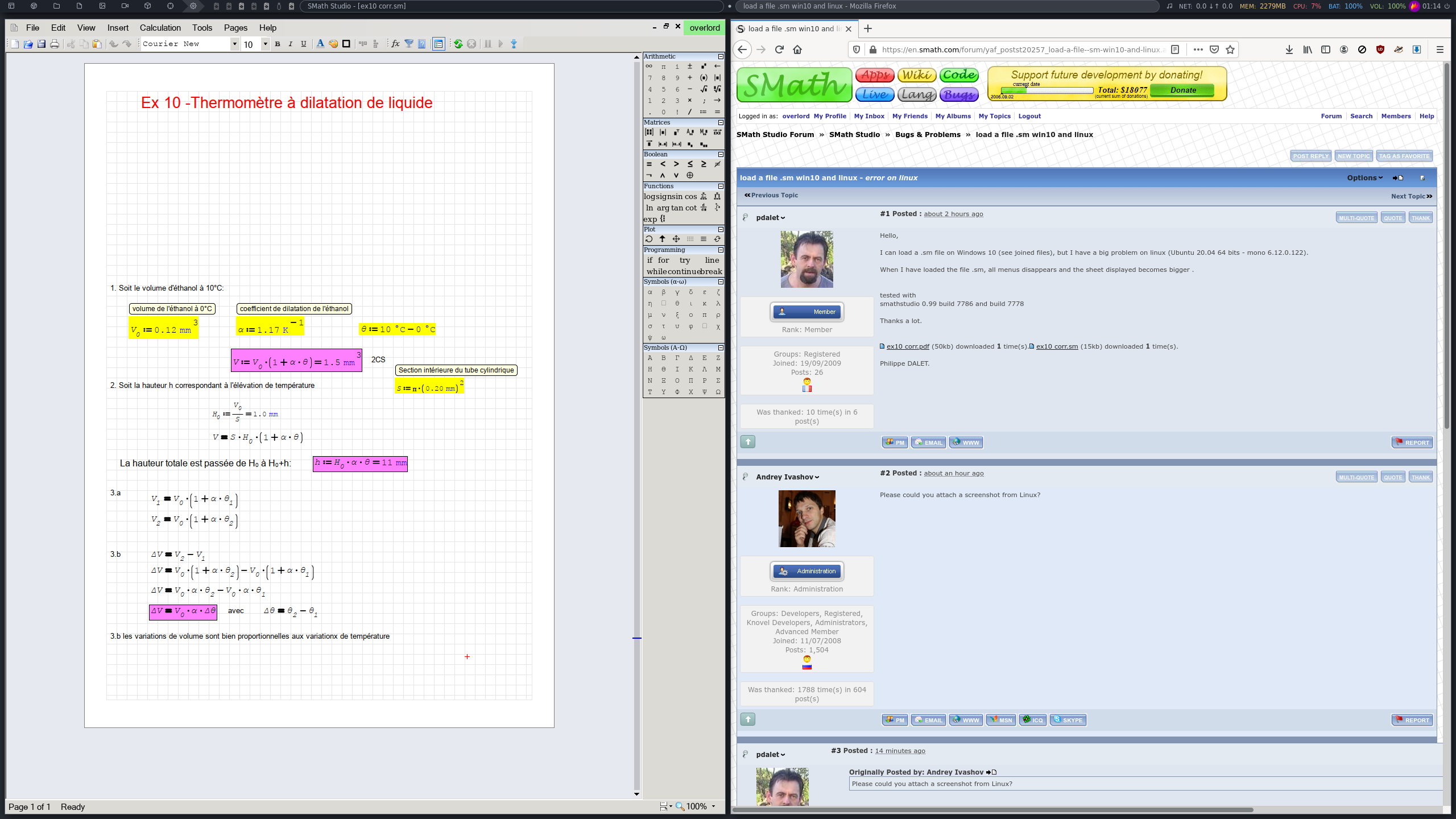

I can load a .sm file on Windows 10 (see joined files), but I have a big problem on linux (Ubuntu 20.04 64 bits - mono 6.12.0.122).
When I have loaded the file .sm, all menus disappears and the sheet displayed becomes bigger .
tested with
smathstudio 0.99 build 7786 and build 7778
Thanks a lot.
Philippe DALET.

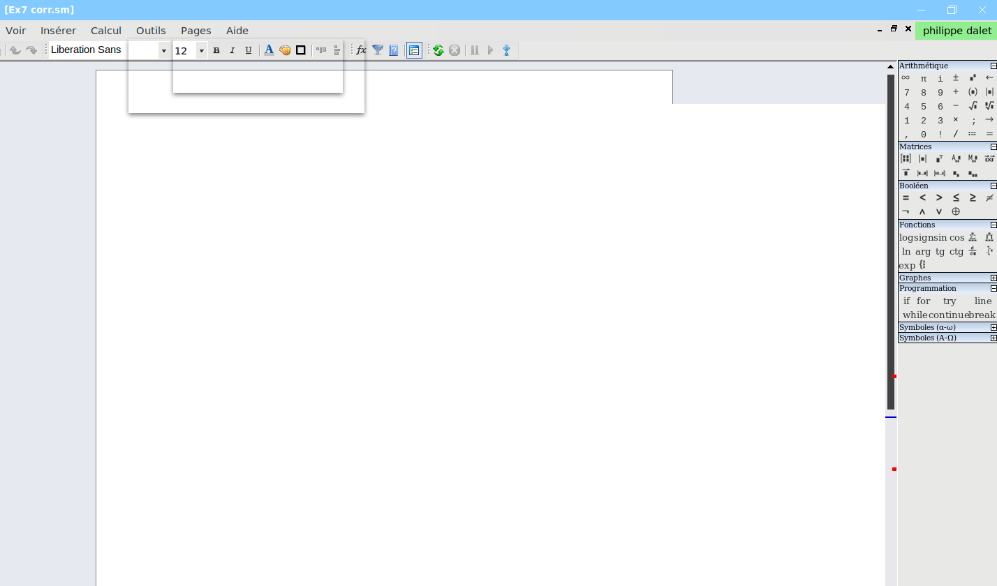

Please could you attach a screenshot from Linux?
#3 Опубликовано: 26.04.2021 18:59:21
philippe dalet
philippe dalet
18 сообщений из 34 понравились пользователям.
philippe
Andrey Ivashov 26.04.2021 19:42:00
#4 Опубликовано: 26.04.2021 19:15:06
Nothing is wrong with my setup.
#5 Опубликовано: 26.04.2021 19:42:52
2 343 сообщений из 4 042 понравились пользователям.
Группа: Super Administrator
Thank you. Will check this issue.

Hello Andrey,
I have found the origin of the bug.
In text region (only on linux)
changing
with
eliminates the bug.
no bug on Win10
ph.D
Andrey Ivashov 09.05.2021 07:11:00
#9 Опубликовано: 09.05.2021 07:44:28
Hello.
changing
with
eliminates the bug.
Please could you try to replace "Arial" with some another Font name installed on your system? Unfortunately I cannot reproduce a bug, but maybe it is because Arial is not available on your system?
If other fonts will work I think I could try to fix this problem.
#10 Опубликовано: 09.05.2021 19:32:42
philippe dalet
philippe dalet
Hello.
changing
with
eliminates the bug.
I have install Arial fonts on ~/.fonts folder, and the display is correct.
All is OK
Thanks.
