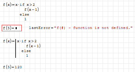

Two things I want to note:
  1. Over time, recursion has changed in SMath: in the past, it was possible to use recursion directly; currently it seems to require a programming function like line(), otherwise it reports "function not defined" error.
  2. Recursion isn't safe; improper termination condition that leads to infinite recursion will crash SMath. Try f(x):line(f(x),1,1) followed by f(2): (just remember to save your work first).
The latter indicates stack overflow, and absence of recursion depth checking. I hope that SMath will eventually implement a means of stack overflow protection, so that in such cases it will simply report "cannot evaluate: nesting too deep" instead of crash.
Also, it would be great if Andrey considered a kind of tail recursion optimization in the future.
