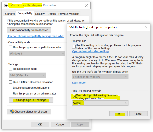

Please note:
  1. There are some known bugs with Worksheet scrolling - will be addressed soon;
  2. There are some UI issues on environment with high DPI (some Custom plug-ins may not be scaled correctly).
    Please use the following to disable high dpi support if required:
