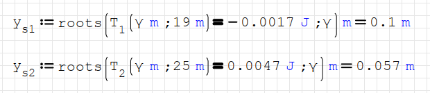

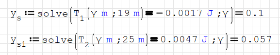

I copied "25 m" to the first parameter,
then I replaced the number "25" with parameter "y",
as a result there was parameter with units like "y m"
and after that the "solve" started to work.
If I write "y" then press ' - I cannot add units.

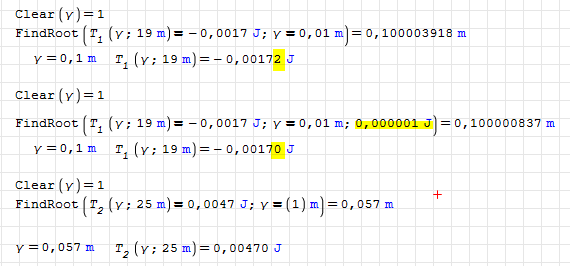

In your case the FindRoot() function from the Nonlinear Solvers plugin seems to be appropriate.
It can handle variables with units and has embedded assignment (the solution is assigned to the variable. The solver requires an initial guess, which also tells the solver what unit to use. Another advantage of the solver is the precision control. In your case, the default precision seems to be a bit sloppy.
minimal_model_Kr.sm (94,18 КиБ) скачан 1216 раз(а).

Hi. For add units to a variable you need multiply it by the unit, this is what you need to write with the keyboard:
y.s:roots(T.1(γ*'m,19*'m)≡-0.0017*'J,γ)*'m
You can add units to y.s writing y.s*'m. When you copy "25 m" the clipboard have just "25*'m".
For understand the behavior of solve with units, you can think in this way: solve don't handle units, but your T.1 do, so if solve try to evaluate T.1(γ,19*'m) returns an error because units don't match, the workaround is tell solve to call T.1(γ*'m,19*'m). This make solve to work, but the answer is unitless. Next, you can add the correct unit to the answer, which if there are nothing strange it must to be the same unit that you need to add to γ getting the correct expression for solve adding two 'm in the expression
This note is for answer your doubts about solve, not for recommend to use it. As overlod points, in your case could be better to use roots, which have the same issues than solve with units and the same workaround, or use FindRoots as mkraska shows using units in the guess values.
Thank you, it would be good to write this here: Units
