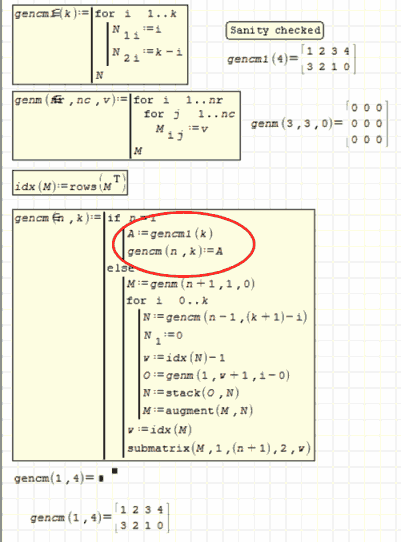

Up to this point, 'n-simplex' is not very successful.
This one is awaiting to be Doctored
Thanks in advance ... Jean

Here you have
Maths Simplex_fix.sm (228,2 КиБ) скачан 1224 раз(а).

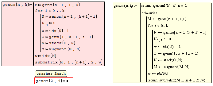

P.S. crash on infinite loops is a known bug: SS-2294
- fixed wrong instructions of exit point when n=1 (missing in the left side of the screenshot above BTW);
- made initialization of local matrices of gencm1(), genm() because same names are used on a parent level;
- missing a -1 in definition of O;
- (optional) submatrix() made with ranged indices;
