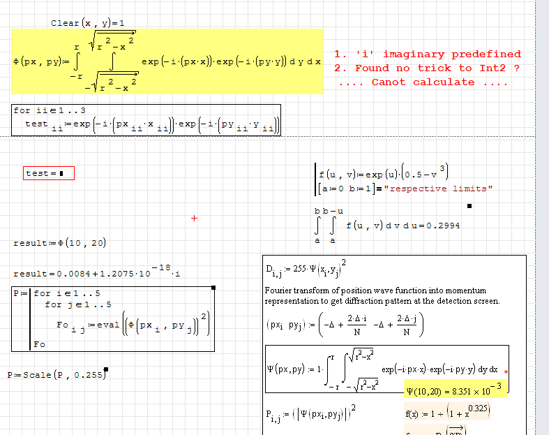

Hello "Doctors",
Can't make it work !
Fourier Quantum CoC.sm (72,62 КиБ) скачан 916 раз(а).

I think you want to clear variables x and y before the definition of Phi. That seemed to get result to evaluate for me. It isn't exactly the same value as shown in the Mathcad Snapshot, but its close.
Edit: The other thing you could do is change the variables of integration to something other than x and y.

... thanks collab for helping. I don't catch "Clear(x,y)"
Worst: it must be evaluated !!! Clear(x,y)=1 [Accepted].
One bug remains in 6179: if the function is complex,
CAN NOT use index 'i' ... a minimal setup is now running.
Will report is it stops calculate.
Smath integrator is horribly slow, even at minimal accuracy.
