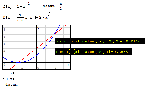

#3 Опубликовано: 11.04.2023 09:44:34
How do you perform such calculation ?
That's my understanding ?
Cheers ... Jean.

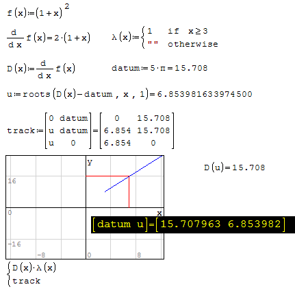

#4 Опубликовано: 11.04.2023 09:53:17
... Smath document.

#5 Опубликовано: 11.04.2023 10:01:35
Hi. If you use maple, maybe this could help.
diff-issue.sm (25,8 КиБ) скачан 1361 раз(а).

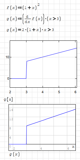

#9 Опубликовано: 11.04.2023 18:41:37
Hello everybody,
I have issues regarding diff function and boolean function.
I have been looking on different solution on the forum, but i have not found a related post.
How do you perform such calculation?
diff() function can't parse if original function has boolean expression.
Once derivative is completed result can be booleaned. (is this even a proper word )
Here how it is.

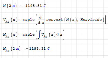

Do you have any idea on how to solve?
Yes. Use maple(diff(convert(M(x),Heaviside),x)) for convert SMath sign function into Maple Heaviside's. It looks ok now:
e7_5_3-hs ok.sm (139,5 КиБ) скачан 1392 раз(а).
