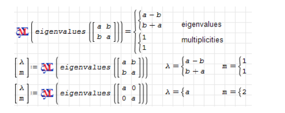

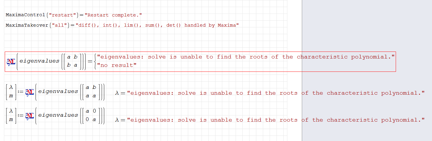

i'm studying SMath with Maxima (written by Dr. Kraska)
but i did not get the result.
my result is this.
smath with maxima.sm (94,66 КиБ) скачан 1165 раз(а).
thank you in advance

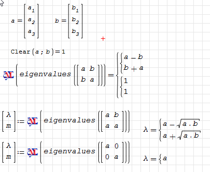

You have to clear the values of a and b. These must be scalar variables, in your sheet these are vectors.
