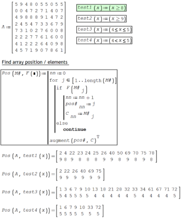

#5 Опубликовано: 27.06.2023 12:13:11
NDTM Amarasekera
NDTM Amarasekera
Another method
Array_Pos.sm (14,76 КиБ) скачан 1426 раз(а).
#6 Опубликовано: 27.06.2023 14:51:06
RegRetired
RegRetired
8 сообщений из 144 понравились пользователям.
Ndtma,
Thanks; however, I don’t understand the large numbers in your answer, which are greater than the size of the matrix.
Sorry for my lack of understanding.
Reg CurryLoveland, CO
#7 Опубликовано: 27.06.2023 16:48:45
Ndtma,
It's the item position by linear indexing. Elements can be accessed using a single index, that is the position sorted by rows (base 1). f.e. The 2nd element in the 3rd row is indexed (3-1)*cols(matrix)+2

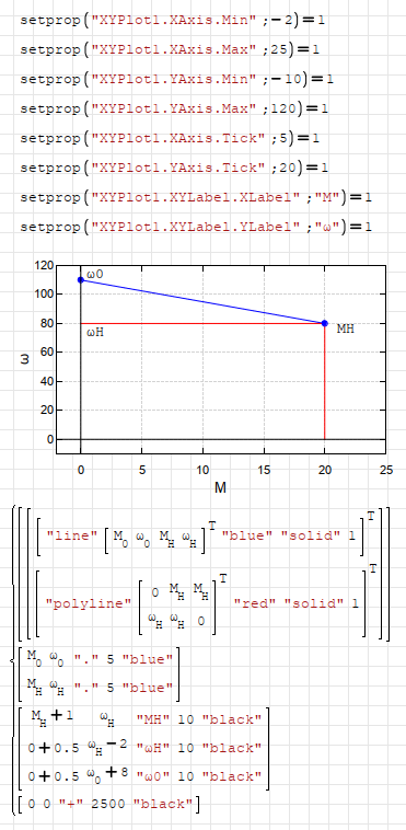

#10 Опубликовано: 27.06.2023 18:53:46
Is there a simple way to return to the original view when I accidentally move my mouse wheel.
Thanks again.
You can try to learn setprop() function for X-Y Plot.
https://en.smath.com/forum/yaf_postst1774_X-Y-Plot-Region.aspx
https://en.smath.com/forum/yaf_postsm59088_X-Y-Plot-Region.aspx#post59088
Here is a simple demonstration I posted before.
DPT_NV plot.sm (20,47 КиБ) скачан 1503 раз(а).
