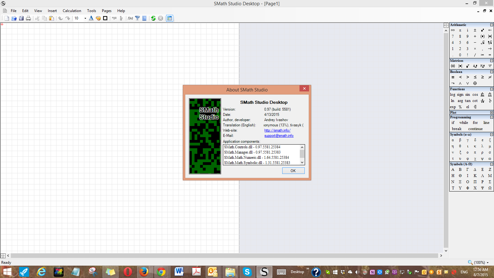

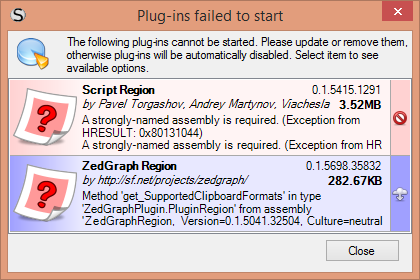

I attach the Insert menu and the Help>About.
Can I try something to help solve the problem?

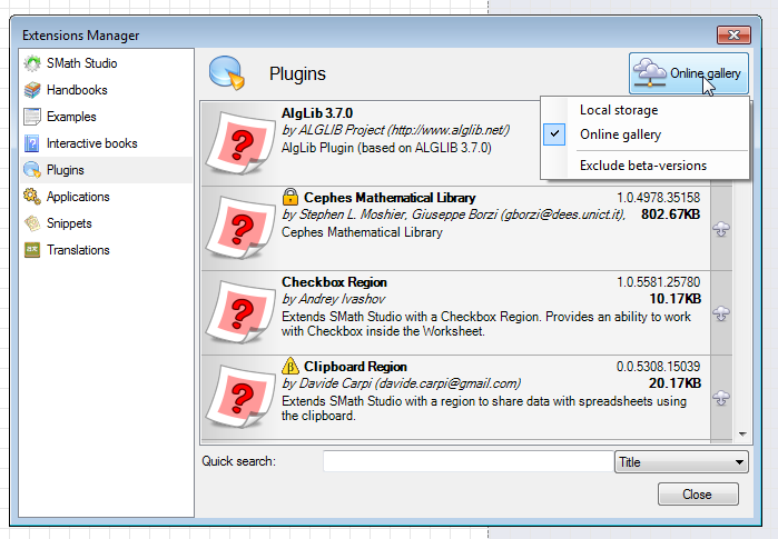

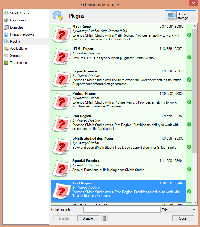

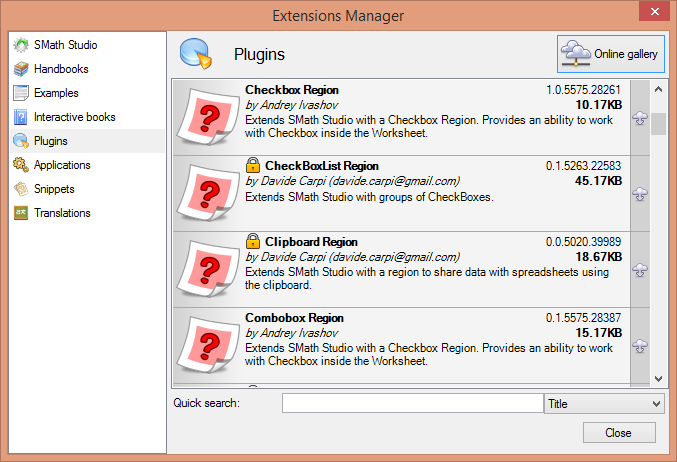

Looking at your screenshot seems you have just the built-in plug-ins (that is ok in a clean install). Have you tried to download a plugin from the gallery? (f.e. the "Checkbox Region" in the screenshot or any other Region plugin)
#6 Опубликовано: 07.08.2015 10:39:07
Basile
Basile
8 сообщений из 172 понравились пользователям.
Davide,
Yes, this solves the problem.
The additional plug-ins are under "On-Line Gallery" button.

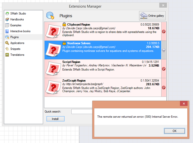

During installation the:
Clipboard Region
and
Nonlinear solver give an error
While the
Script Region
and
ZedGraph
fail

The "Installation failed" error of Script Region/ZedGraph is because these plugins are made for an older version of SMath Studio. If you are interested on them, you may ask the author (uni) to update the plugins.
The server error on Nonlinear Solvers may be related to a wrong password (here the correct one)

I was able to load the "NonlinearSolvers" by providing the correct password. Thank you.
But the other three, I do not know what to do. The "Enable" and "Disable" Buttons are inactive.

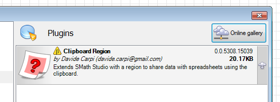

I don't know why but the Clipboard Region is a version not compatible with your SMath Studio.
You have to delete the plugin manually;
- close SMath
- go to the folder %APPDATA%\SMath\extensions\plugins\
- delete the folder 0e45de64-570b-4407-8352-6fb6ab358782
The uninstall button disabled may happens if you have installed by yourself the plugins in the SMath studio folder (Program Files (x86)\SMath Studio\Plugins)
In the latter case delete any non built-in plugin from that folder.
Then open again SMath and check the gallery, you should see the Clipboard Region version 0.0.5308.15039. If you still have the older version let us know.

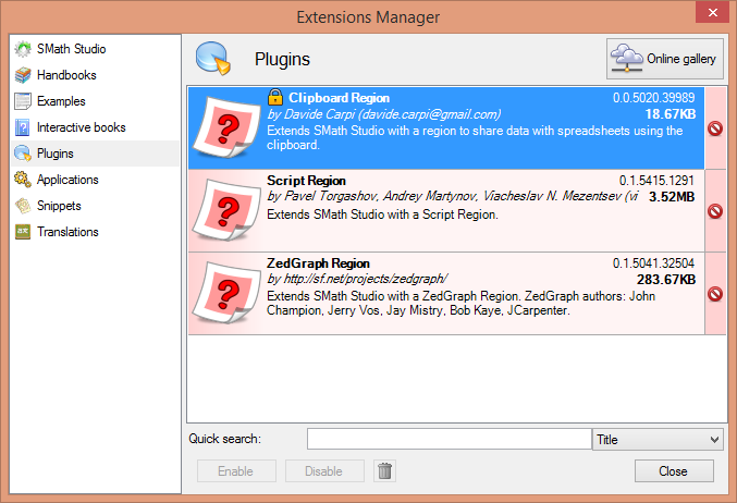

"...you should see the Clipboard Region version 0.0.5308.15039."
When I am opening SMath I get another version. (SMath07)
"The uninstall button disabled may happens if you have installed by yourself the plugins in ..."
I did default installation.
When I start SMath, I get (SMath06)

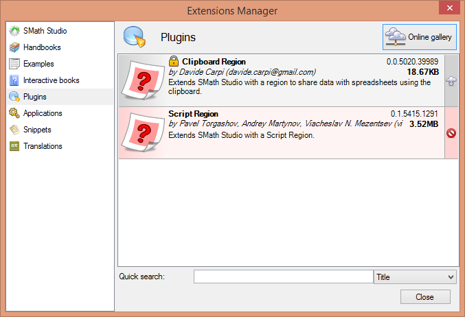

The Clipboard Region still (after deleting the plugin from its folder)appears as an older version 0.0.5020.39989 instead of the newer version in the Extensions Manager>Online Gallery.
Attempt to install results in Installation failure.
Please, see icon in previous message above.
Any ideas?

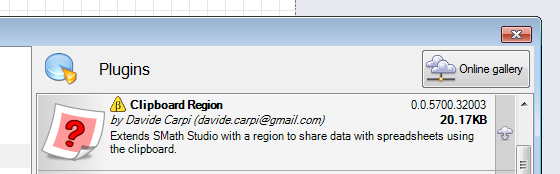

Because your is a full clean installation I suspect there's a server-side error, or some settings wrong with my previous upload...
I've recompiled and uploaded the plugin for the latest beta build (SS 0.97.5581), please check if this is available and works for you (ClipboardRegion version 0.0.5700.*)
