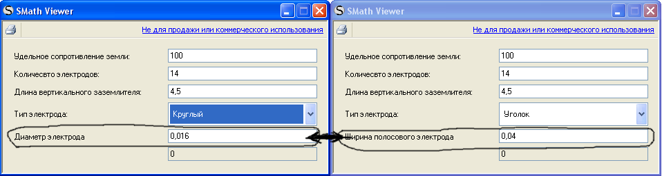

I'm a Russian engineer. We have a lot of calculations which, depending on the parameter chosen earlier, change the future types of data to be entered. For example, when calculating the ground: If the rod is a round data set one. And if you select a corner, then the data set is different. How to solve the problem of choosing formulas I found, but there is no input of data types.
I want to make a simple calculation with an output list of bar types, and below them is the data entry area, which will vary depending on the selected rod. Most likely this function already exists and is solved as an area, but I did not find an example. Help please an example or say there is such a functional?

A new simple example is the question:
There are two formulas: the sum and multiplication
When selecting a sum in the viewer, only the parameter b
When selecting a multt in the viewer, only see the parameter c
Now I see both parameters, although one of them is not needed
Is it possible to remove one of the options depending on the choice?

Try this method:Answer1.sm (4,56 КиБ) скачан 1724 раз(а).
neurosedd 19.07.2017 10:00:00
WroteTry this method:Answer1.sm (4,56 КиБ) скачан 1724 раз(а).
Thank you so much! This works for me. I would like to be more elegant, but this method is also workable.
