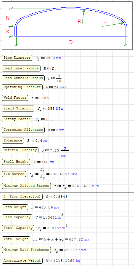

Basic torispherical head thickness finding for pipe testings.
Sample also contains a primitive drawing with 2D plot.
Calculation is based on EN13445-3 standard.
torispherical_cap.sm (44,91 КиБ) скачан 1537 раз(а).
torispherical_cap.pdf (198,3 КиБ) скачан 923 раз(а).
PS: h calculation corrected version (for volume and mass):
torispherical_head_v2.sm (70,99 КиБ) скачан 1540 раз(а).

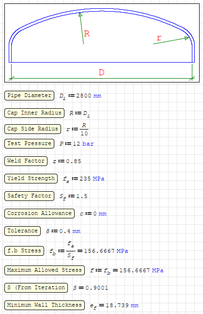

Height, Volume, Mass calculations are added.
Drawing is slightly revised according to those.
torispherical_head.sm (69,19 КиБ) скачан 1547 раз(а).
