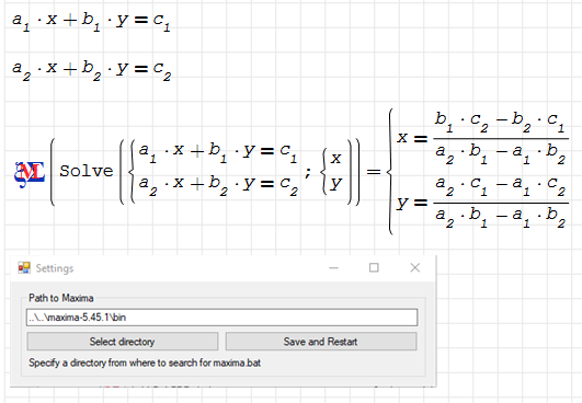

#1 Posted: 2/12/2022 10:35:35 AM
Such as this
a.1*x+b.1*y≡c.1
a.2*x+b.2*y≡c.2
How to get symbolic results for x and y
1.sm (3.01 KiB) downloaded 1208 time(s).
a.1*x+b.1*y≡c.1
a.2*x+b.2*y≡c.2

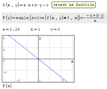

#4 Posted: 2/12/2022 11:55:56 AM
... get lot more from maple companion.
ODE Symbolic Verhulst [Logistic].sm (25.55 KiB) downloaded 1022 time(s).

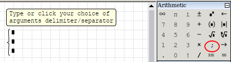

#5 Posted: 2/13/2022 9:31:52 AM
How to input more than 2 equations in Solve after curly brace?
There are only 2 placeholders by default.
#6 Posted: 2/13/2022 10:41:49 AM
#7 Posted: 2/13/2022 10:43:42 AM
No, I mean the equations after {
#8 Posted: 2/13/2022 11:12:14 AM
The { is a function built-in SMath, it's called "System of variables or equations".
It's located in the Function side panel.
