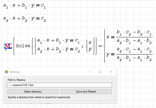

#1 Опубликовано: 12.02.2022 10:35:35
netsonicyxf
netsonicyxf
2 сообщений из 79 понравились пользователям.
Such as this
a.1*x+b.1*y≡c.1
a.2*x+b.2*y≡c.2
How to get symbolic results for x and y
1.sm (3,01 КиБ) скачан 1318 раз(а).
#2 Опубликовано: 12.02.2022 10:53:27
oscar mauricio
oscar mauricio
1 сообщений из 10 понравились пользователям.
Hi, It's posible whith Maxima Plugin
netsonicyxf 12.02.2022 22:27:00

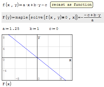

#4 Опубликовано: 12.02.2022 11:55:56
... get lot more from maple companion.
ODE Symbolic Verhulst [Logistic].sm (25,55 КиБ) скачан 1119 раз(а).

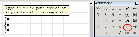

#5 Опубликовано: 13.02.2022 09:31:52
netsonicyxf
netsonicyxf
How to input more than 2 equations in Solve after curly brace?
There are only 2 placeholders by default.
#6 Опубликовано: 13.02.2022 10:41:49
Did you mean in Solve within curly brace ?
Maybe from the f(x) menu ...
FindRoots(2) ... FindRoots(3) ... FindRoots(4)

#9 Опубликовано: 13.02.2022 11:27:27
This includes expanding vectors, adding new arguments to functions, etc.
