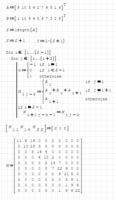

This algorithm should do it.
Just replace X,Y values and A,B matrices with yours.
Don't know what your 999 row is, so I have improvised.

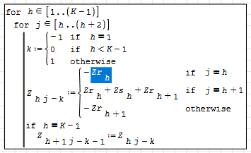

I have tried your algorithm on my data and it seems to work. I checked it on a 38 x 38 matrix and it does the job perfectly.
Unfortunatelly I am not able to use it for my purposes because it takes forever to execute for bigger matrices... My final matrix is not 1000 x 1000 - it's 2688 x 2688 and for this matrix the algorithm did not complete for 15 minutes (I have terminated calculations after this time). It did not complete for 1000 x 1000 as well (but in this case I have terminated calculations after 5 minutes). Is there anything I can do to speed it up?

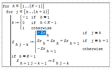

Hi Xylene. First of all, try not to use i if you are going to use complexes, as you would be redefining it, and i is not a protected or special variable, like in Mathcad or other CAS.
Next, notice that in this version of the lasso the opposite of the entire vector is first found, and then the element is selected.
while in this other one the element is first selected and then the opposite is found
Yes, they look the same, but they are not. These improvements bring the code to a few seconds for a few values, but it's still slow for the larger array.

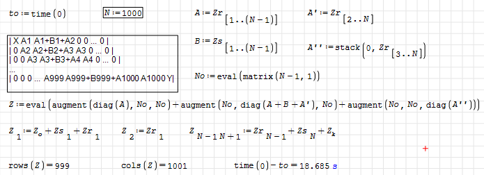

Finally you could try using diag to fill a matrix with the diagonal values, and augment(0,diag(X)) or stack(0,diag(X)) to create subdiagonal or similar matrices and add to the diagonal matrix. In theory that should be the most efficient way to build the Z matrix.

WroteIs there anything I can do to speed it up?
Please find my file with necessary data attached below.
Using diag() and submatrices sure speed things up.
Not that fast enough (5 mins), but it finished at least.
Previous solution was still at i=821 after 12 mins when I paused it.
Maybe someone make it even faster, that's all I can do for now.
Here is your file with new algorithm.
Matrix_diag.sm (114.43 KiB) downloaded 1353 time(s).

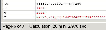

Maybe this is a silly (and off-topic) question but how can I check on what stage is the program in calculations? Where does that information i = 821 after 12 mins come from?
I know that there is a green progress bar in the bottom right corner, but this bar shows only the number of current operation and not the number of iteration in current operation.
PS pausing the program causes error and results in shuting it down.
#10 Posted: 2/7/2023 7:30:22 PM
Wrotebut how can I check on what stage is the program in calculations?
I simply paused it. In debug panel I looked for i value.
It was 821 while time was around 12 minutes at bottom bar.
I use linux, SMath doesn't crash on me when I pause the process.
Monitor your ram usage while running algorithm
That's what come into my mind with info I have.
PS: I rerun my bad code, it was just past half of your data.
And it took 20 mins to get there, don't use file with for() algorithm.
Use the one with diag(), it completes in 4 minutes.
