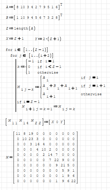

This algorithm should do it.
Just replace X,Y values and A,B matrices with yours.
Don't know what your 999 row is, so I have improvised.
fillmatrix.sm (12,66 КиБ) скачан 980 раз(а).

I have tried your algorithm on my data and it seems to work. I checked it on a 38 x 38 matrix and it does the job perfectly.
Unfortunatelly I am not able to use it for my purposes because it takes forever to execute for bigger matrices... My final matrix is not 1000 x 1000 - it's 2688 x 2688 and for this matrix the algorithm did not complete for 15 minutes (I have terminated calculations after this time). It did not complete for 1000 x 1000 as well (but in this case I have terminated calculations after 5 minutes). Is there anything I can do to speed it up?

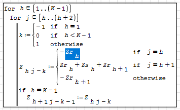

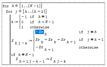

Hi Xylene. First of all, try not to use i if you are going to use complexes, as you would be redefining it, and i is not a protected or special variable, like in Mathcad or other CAS.
Next, notice that in this version of the lasso the opposite of the entire vector is first found, and then the element is selected.
while in this other one the element is first selected and then the opposite is found
Yes, they look the same, but they are not. These improvements bring the code to a few seconds for a few values, but it's still slow for the larger array.

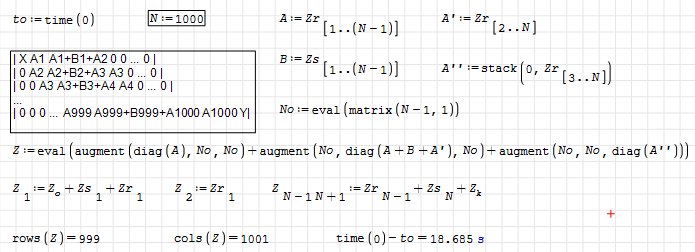

Finally you could try using diag to fill a matrix with the diagonal values, and augment(0,diag(X)) or stack(0,diag(X)) to create subdiagonal or similar matrices and add to the diagonal matrix. In theory that should be the most efficient way to build the Z matrix.

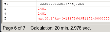

Monitor your ram usage while running algorithm
That's what come into my mind with info I have.
PS: I rerun my bad code, it was just past half of your data.
And it took 20 mins to get there, don't use file with for() algorithm.
Use the one with diag(), it completes in 4 minutes.

My grain of sand. The described algorithm does not return a square matrix, but one with two more columns than rows. This would be the most efficient way to calculate it.
