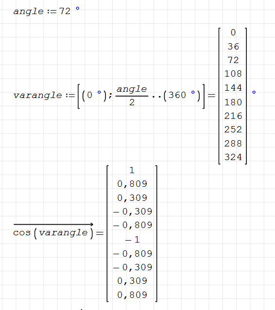

I'm trying to convert some old Mathcad files into SMath but am stuck with what must be an elementary problem, I've looked at various tutorials but can't find a solution, no doubt due to my own incompetence.
I am defining the following variables: angle:=72 and varangle:= 0, angle/2..360
In Mathcad if I then define: test(varangle):= cos(varangle) the output of test(varangle) displays correctly in a column.
If I try the same in SMath I receive either an 'argument must be scalar' or 'fill in all empty elements' error.
Thanks for any advice.
Screenshots of Mathcad and SMath attached.
btw, great software.

#2 Posted: 10/3/2012 7:49:27 AM
Correct me if i'm wrong, trigonometric functions don't support arrays currently.
For now, you can do something like this.
cosinOfArray.sm (5.04 KiB) downloaded 1329 time(s).

#4 Posted: 10/3/2012 11:31:19 AM
You can convert the vector into a system (by w3b5urf3r_reloaded)
Regards, Ber7
https://smath.com/wiki/GetFile.aspx?File=cosinOfArray%5b1%5d.rar
Regards, Ber7

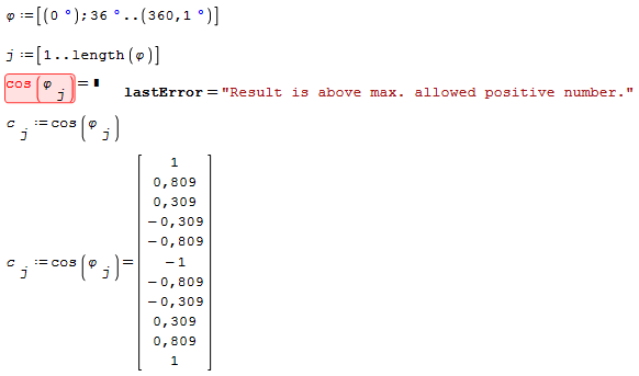

#6 Posted: 9/28/2024 2:44:50 PM
WroteCorrect me if i'm wrong, trigonometric functions don't support arrays currently.
did arrays appear in trigonometric functions?
#8 Posted: 9/29/2024 10:22:50 PM
An alternative to the vectorize() function is the use of index vectors.
They, however, only work if they are used in a definition.
Worksheet1.sm (5.28 KiB) downloaded 1119 time(s).
