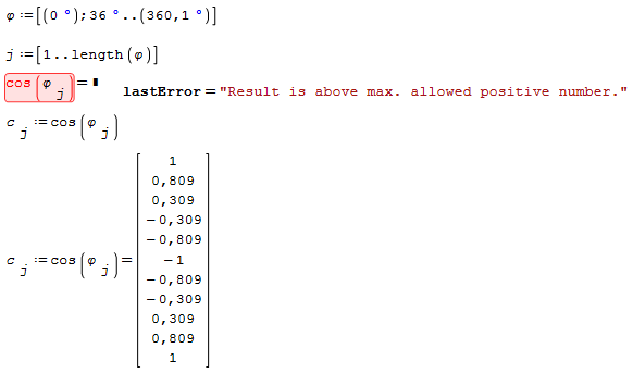

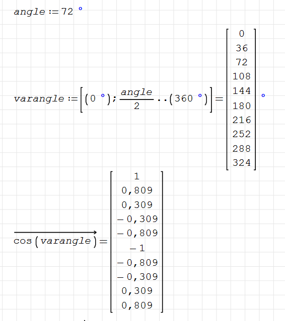

now you can use the "vectorize" function, which you also find in the side panel, and perform the trigonometric function element by element.
1752 28.09.2024 16:30:00
#8 Опубликовано: 29.09.2024 22:22:50
An alternative to the vectorize() function is the use of index vectors.
They, however, only work if they are used in a definition.
Worksheet1.sm (5,28 КиБ) скачан 1631 раз(а).
sergio 29.09.2024 23:37:00
