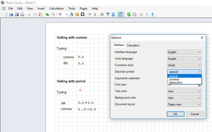

- while setting dot for comma, after typing comma a multiplication appears. Would be nice if, after typing comma here, the dot comma appears. In the opposite way it works.

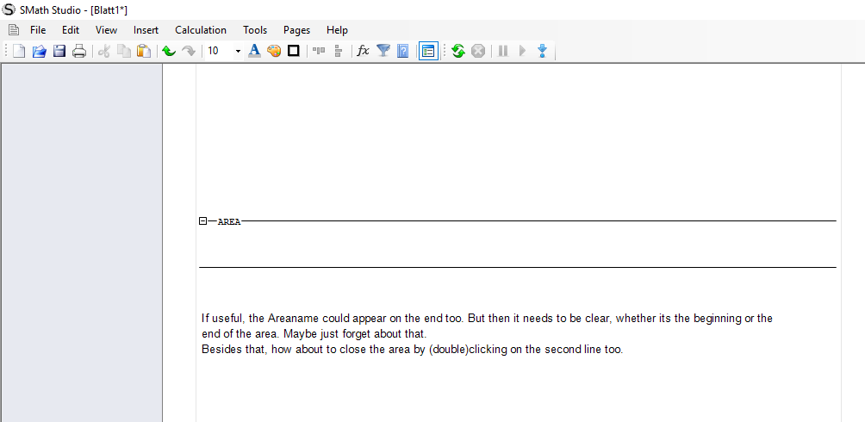

- the area name should also appear at the end of the area shouldnt it? And if I could close an area at the end of it too, that would be great.

Multiplication exists in 3 styles [2*ln(x), 2.ln(x), implicit 2ln(x)
Smath style is unique 2.3.4.5.6.7.8.9=362880
Implicit style is confusing.
coma [,] or [;] for arguments separators.
What is an area ?
In Smath, you insert an area to collapse math/text/image ... regions.

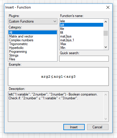

BTW, if neeeded, in Custom functions there is a set of functions that wraps ternary comparisons:

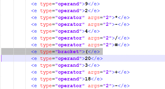

Hi. Or can hack the sm file deleting where "(" appears:
HackingEqual.sm (3.3 KiB) downloaded 1863 time(s).

Hi G-Tate. Difficult. I edit the sm file with a text editor and delete the "bracket" lines:
