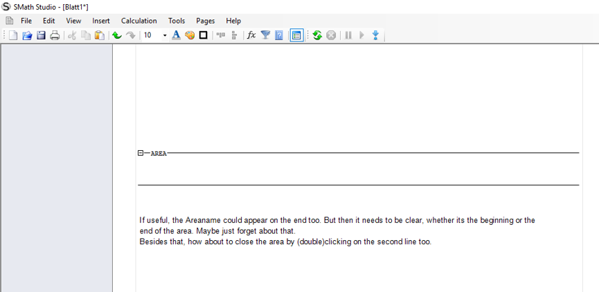

After doing this for a while, it gets really annoying - the area name should also appear at the end of the area shouldnt it? And if I could close an area at the end of it too, that would be great.

What is an area ?
In Smath, you insert an area to collapse math/text/image ... regions.

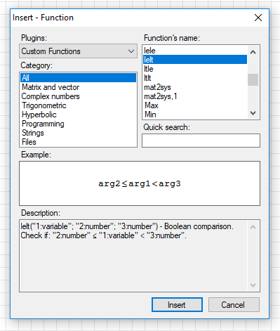

Just to clarify, parentheses in booleans were introduced because often calculations of newbies were affected of wrong statements in if() functions, where you might be tempted to use something like a
BTW, if neeeded, in Custom functions there is a set of functions that wraps ternary comparisons:
![2018-12-04 01_06_48-SMath Studio - [Page1].png](/ru-RU/files/Download/Tobo8Z/2018-12-04-01_06_48-SMath-Studio---[Page1].png)

I should explain that with a picture.
What is an area ?

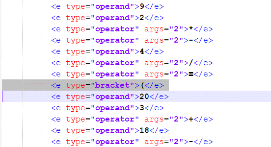

Hi. Or can hack the sm file deleting where "(" appears:
HackingEqual.sm (3,3 КиБ) скачан 1863 раз(а).
Very nice, exactly what I wanted.
Copy paste or changing the content doesn´t work unfortunately.
Is it difficult to do that or is there an easy way?

Hi G-Tate. Difficult. I edit the sm file with a text editor and delete the "bracket" lines:
Thanks very much!
Thats a nice trick to know.
But of course not the real solution.
